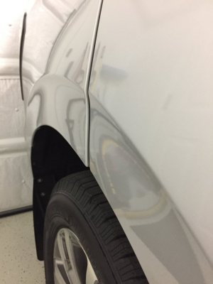

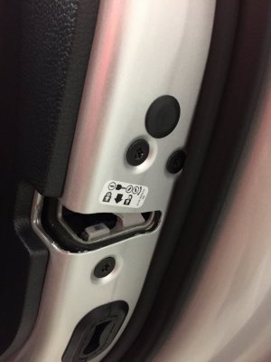

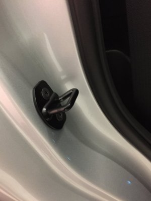

I'd also be interested in what is required for a DIY job to avoid a trip to the dealer. My right rear passenger door doesn't align well with the rear fender. The fender sticks out further than the door. I tried to adjust the door strike, but the holes in the strike have conical seats and don't allow adjustability. The latch mechanism in the door also doesn't have much movement after loosing the bolts and trying to adjust it. See attached photos

The back plates on the striker will glue themselves to the paint. After you loosen the bolts and back them out about 1/8 of an inch, give them a rap with a plastic mallet. That will usually break the back plate loose and allow them to adjust.
