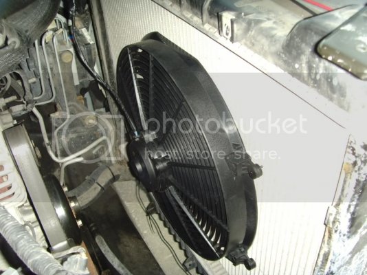

This is what two 16" fans look like. They're on the radiator shroud just so you can see how two 16" won't fit. My mistake for assuming that the F150 and Expy radiator were the same size.
So, two 14" fans should fit in there, which I'll have to get as the summer nears. Right now, I have one 16" Zirgo in there. When I get the 14s, I'll probably put the two 16s in my dad's truck.
Here's how the one 16" looks like. Notice all the free engine space.:D

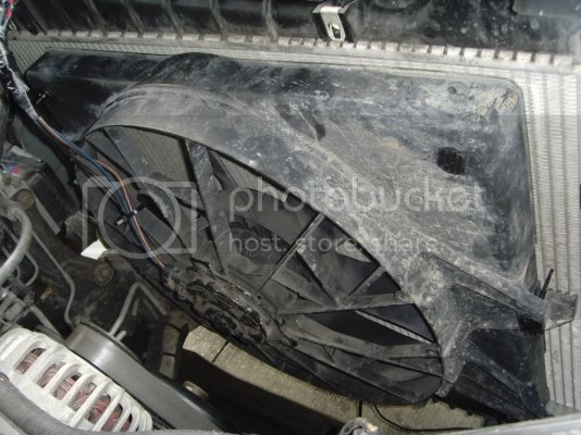

I took out that 16" fan, and went ahead and bought a used Mark VIII fan.
As far as MPG, I haven't really noticed much difference with the fan and UD pulleys. Then again, my driving isn't that conservative either. What I have noticed, though, is that the engine is a lot more quieter and I seem to travel further when coasting down.

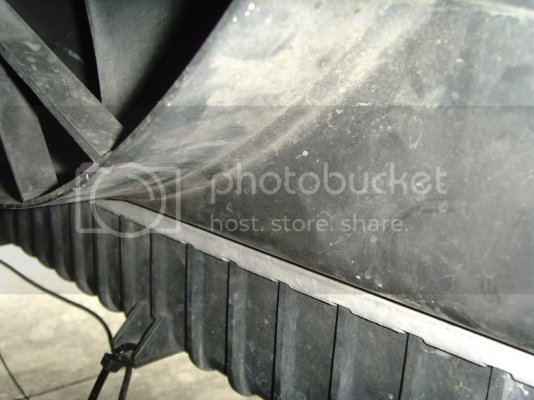

As you can see, I just drilled through the shroud, and used zip ties to fasten it to the radiator.
Most of the weight, though, is on a ledge on the bottom of the radiator.
Look at all that open space. :D

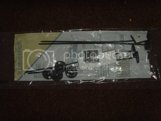

These are the zip ties I'm talking about. I found them at an Advanced Auto for 6 bucks. I called in advance, though, because the first Advanced Auto I went to didn't have them.
