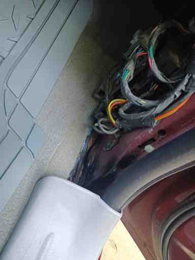

Did you mean this? Which one would I be looking for? The ground bolt looks good, this was under the passenger side rocker plastic cover.

Well, that's the kick panel. The wiring corrosion problem happens a little further back under the rocker panel, which is at the bottom of your picture.

I took that plastic cover off, can't see anything obvious. Do I need to unwrap wires? Maybe go further back?
