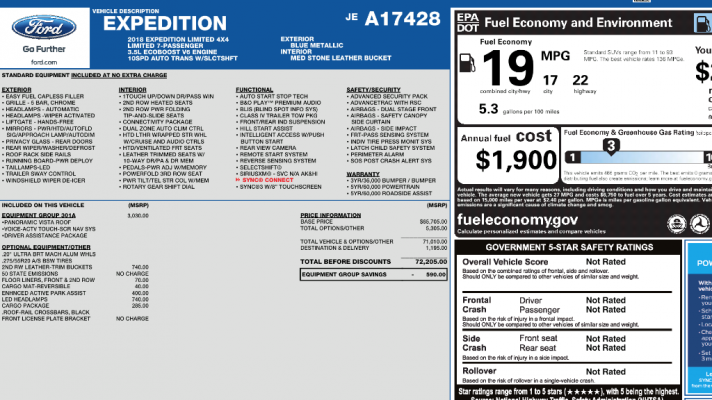

Purchased a fully loaded XLT since I couldn't get a Limited with the lighter Med Stone leather interior or with a bench 2nd row seat. All Limiteds I saw have the black (Ebony) interior and Captain chairs second row seats. Deal breaker for me!
Has anyone seen a Limited with the lighter Med Stone leather interior and bench 2nd row seat or is this not an option?
See link below. Limited w Meduim stone. The question is wether the Meduim Stone is as Nice as the Ceramic on the Platinum?
