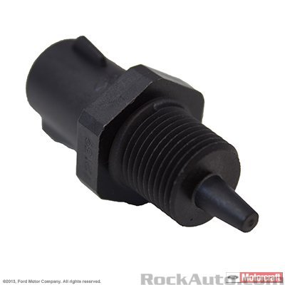

If you pop the plastic shroud off that covers the radiator top area, on the passenger side, near the headlight, you will find the exterior ambient air temp sensor. It's about $22 from Rock Auto if you want to replace it. Was the Expy wrecked in the front end that you know of ? Lotta times that sensor gets busted in front end collisions. See what yours looks like. It's easy to replace.
Outside air temp sensor ....
https://www.rockauto.com/en/catalog...ditioning,ambient+air+temperature+sensor,7000

Did you happen to use a genuine Ford part on either replacement?
AE5Z-12A647-A
I'm on a couple F150 forums and recall threads with the exact same issue -- where generic, Amazon, ebay, etc. Chinese sourced sensors either are DOA or have a very short life span. Replacing them with the twice as expensive Motorcraft version solved the issue. Good luck either way.
