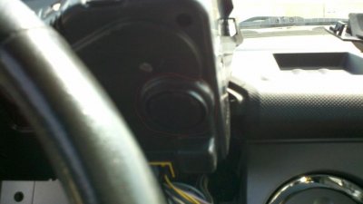

I didn't find the flasher relay but did find the source of the clicking. Unlike most vehicles where the clicking sound is produced by the flasher relay itself, in the 2007 Expedition the clicking sound eminates from a tiny speaker in the back of the cluster. So I will be installing the load resistors this weekend...
