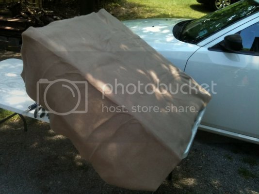

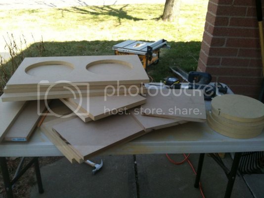

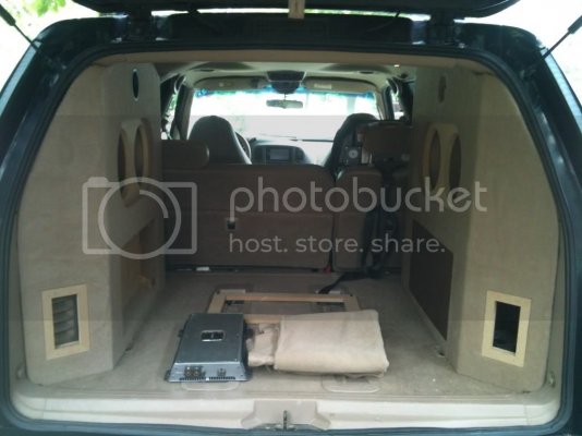

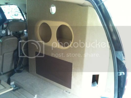

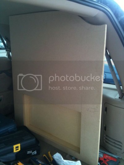

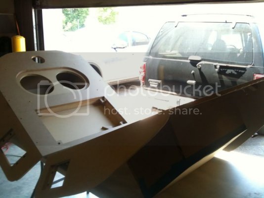

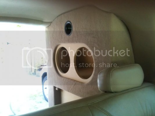

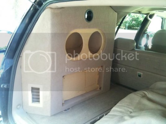

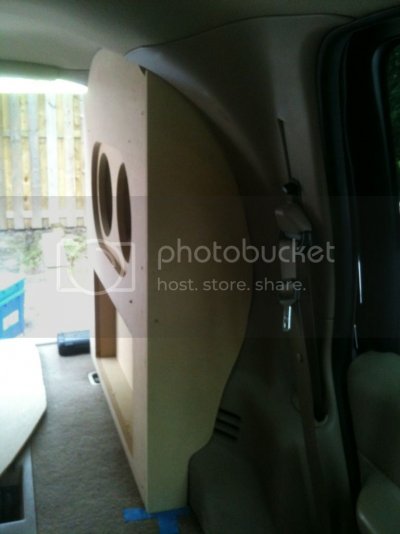

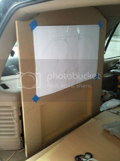

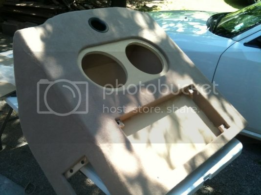

So as of right now the headunit, backup camera, sound deadening in the doors and tailgate all have 3 layers, front and rear speakers are in and power wire and RCAs have been run. I have begun the build on the enclosure/amp rack and am at the stage now where I need to carpet them hppefully tomorrow.
Oh and there will be a 3" port directly above the subs, and if anyones wondering the enclosures are just a hair shy of 1.5cb/f each I could have gotten more but didnt need it for the subs I chose.
Either way heres a few pics.

Damn that is clean. Great job on the rear boxes. I am going to be attemping my install probably next week. Pioneer AVH-P8400bh with 4 rear monitors and am pretty terrified about blowing something up. Should be interesting.

Nice work on the shaping, are you going to use some rubber or silicon matt between the wood and the plastic side panels?

jered22, measure measure measure lol I think I measured and sized the headrest monitor 5 or 6 times before i cut anything. Its actually alot easier than you think.
Capitan M, yeah I have 1/2" foam tape that will be put on the perimeter of the the whole box, both sides then the carpet overtop. theres still some places I need to fill in first before that happens so that it is a consistant 3/8" gap around.

Ontario Canada
