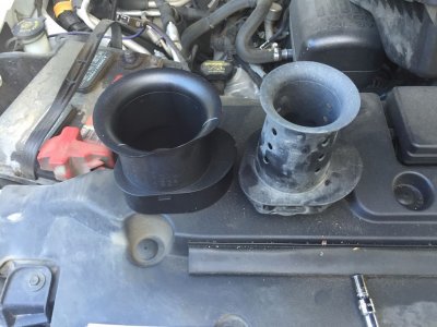

Hawaiianbasshead
Dec 18, 2016
59
Big Island HI
http://www.instructables.com/id/Gotts-Air-Intake-Mod-Ford/?ALLSTEPS
Google ftw, 2012+ snorkel in itself is larger and flared and a direct swap..... and cheaper than pvc.. part numbers vary I think there were 2 for sure. It's on my list of things to get soon my 07 isn't yet on the streets anyway but I will be swapping to the newer snorkel. Phones are lagging so I tried typing this multiple times and currently using a shattered phone as its lagging less than my nice s7 *facepalm* but yeah, maybe check it out =)
Ford part numbers are on the how to'
Really imo the one on this forum should be a sticky in the how to and 3rd gen sections to be able to upgrade to the larger snorkel for like $7. If I get it I will try to do a small how to =)

After having it in a couple months I am still convinced the 2012+ intake snorkel swap was a great mod.
Noticeable power increase? Not sure since I have custom tune.
Butt dyno? Not sure
Sound change? Negligible
Economy? I think a little bit but hard to tell as wife tends to do the "I used the Expy so I put $20 in it" idiocy and throws off numbers.
