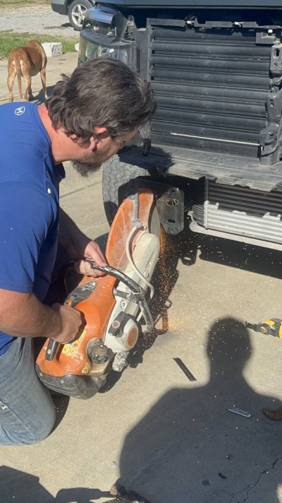

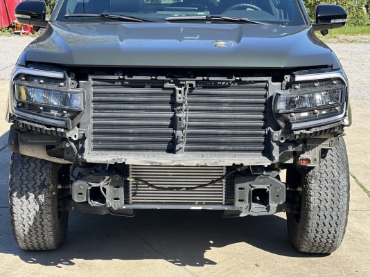

The bumper is from Ironman 4x4, it is intended for an F150. I did have to do a little cutting on the frame horn bumper mounts. Took maybe 3 minutes. Disassembling the front bumper plastics took longer. After I had the bumper mocked up I slid the plastics behind into place marked my cuts and put the rubber trim on. The lights in the bumper are from Ironman but the 4 big lights are cheap Temu units (like $25 each) but the give out plenty of light for our needs. We may upgrade to BajaDesigns later but with 2k on the bumper and winch, 2k on the Icon lift I ordered and 2500 on wheels and tires I had to cut cost somewhere. The lift should be here next week. I’ll update a pic with the bead locks and 35s once I get it finished.
