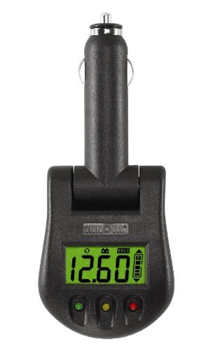

Doubtful it would affect transmission downshifts. As far as your electrical questions, most vehicles will show a warning light for low battery (amber typically) and alternator issues (red normally). Alternator being more critical is shown in red so you will address it with more urgency. Low battery voltage is not as critical so is shown in amber. A simple device like this plugged-in to your 12V outlet can show you the health of battery (read with the engine off) and alternator/charging (read with the engine running). voltmeter.jpg

Doubtful it would affect transmission downshifts. As far as your electrical questions, most vehicles will show a warning light for low battery (amber typically) and alternator issues (red normally). Alternator being more critical is shown in red so you will address it with more urgency. Low battery voltage is not as critical so is shown in amber. A simple device like this plugged-in to your 12V outlet can show you the health of battery (read with the engine off) and alternator/charging (read with the engine running). View attachment 72219
My voltage gauge fluctuates Too much. With heat on / rear defrost and head lights the gauge is down to the point where the battery light is just about to flicker …

Need to get a voltage reading like mentioned, low voltage will cause all kinds of issue's. Including transmission shifting, computers are very sensitive to voltage.
