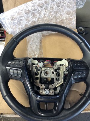

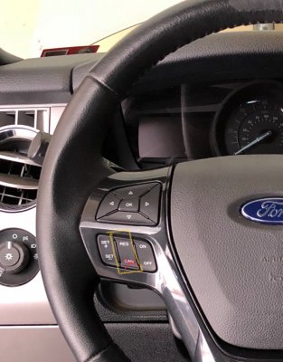

Here's a pic of the HSW I picked up from an Explorer. It bolts directly onto the Expy column and plugs into the Expy clock spring.

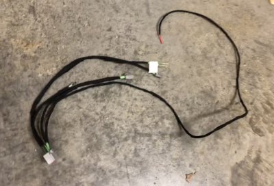

Here’s a pic of my wiring harness...thanks to @Lucas8888 on the F-150 forum. Only one wire to splice, that’s the long wire (with red end)...it goes to the BCM or I could tap into another switched power source. The rest of the harness is plugs and inserting 2 pins into the harness/connector at the clock spring.
