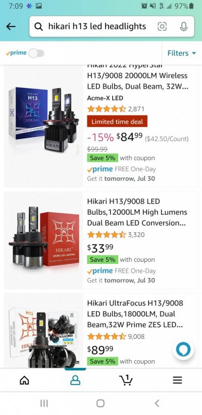

Long delayed reply....I ended up getting LEDs from Hikari from Amazon, $20 flash sale long ago. So happy with them, they are 6k and soooo bright.....SO bright they ended up being recalled for being too bright. I ended up keeping them in.

Hey ededdily, would you provide the Amazon link to LEDs that you installed. Been looking to improve forward lighting myself. Thanks.
