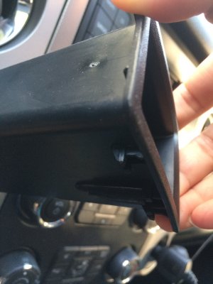

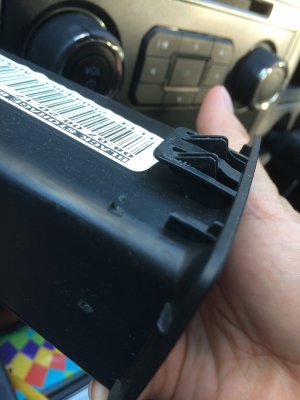

Looking to add the brake controller so curious if one just pulls the cubby straight out or if the panel needs to be removed and something unclipped from the back?

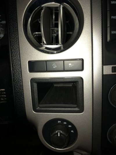

Also for you folks with the fancy models what button do you all have to the left of the hill control and traction control button??

Left blank button is the power tail gate
the Hill decent button is blank on 2wd
The Cubbie is the Trailer brake controller (same spot on 2008-2014 F150's)

To remove it do I just pop it out or is it attached on the back that the silver panel needs to come out as well?

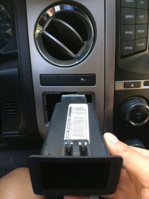

I’ve never taken the dash apart in the Expedition, but looking at the way it sits with that lip, as well as looking at pics of the OEM TBC, it pops out. It’s tough, I tried removing the one from my wife’s truck and gave up because it felt like something was going to break.

This is exactly where I am at. Wanting to make sure there are no tabs that have to be released from the rear.
I am replacing the cubby so don’t really care if it breaks. Just don’t want to break any portions of the silver panel as I am going to presume they are not cheap.

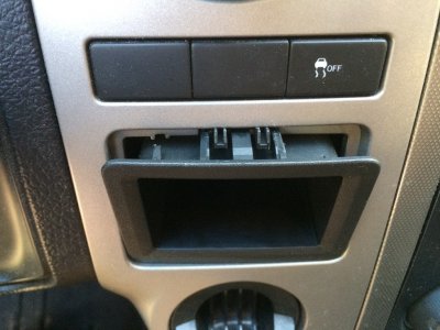

Expedition and F150 bin/brake controller or mounts different? The top video makes the bin just snap out; the bottom one has the bin bolted in. First installation looks easiest but the bottom ain't bad and the guy is probably doing this one-handed and holding the video camera in the other hand.

Yes, all the F-150 cubbies and TBC bolt in from the back, Expedition snaps in from the front.
