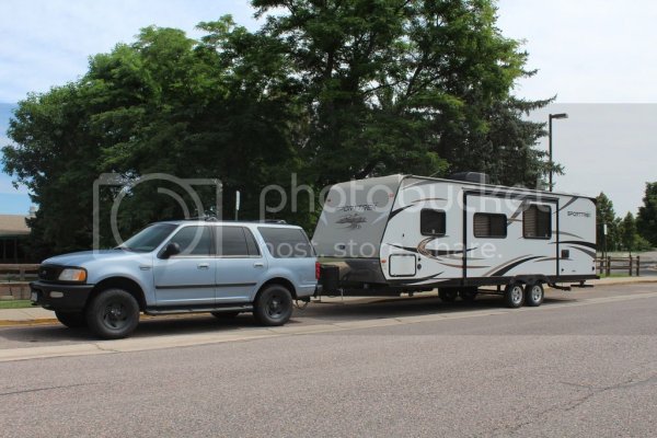

^ one of the reasons I kept the airbags. I can haul anything (heaviest Ive done is carry 12 adults myself included and the expe was level as if it was nothing - def a sweet sight)

I actually am in the same boat. Mine sags really low on my 30' 6500 lb trailer. I was asking a bit back about towing shocks vs air bags. I was going to do what you have suggested, coil over shocks, air lift 1000.

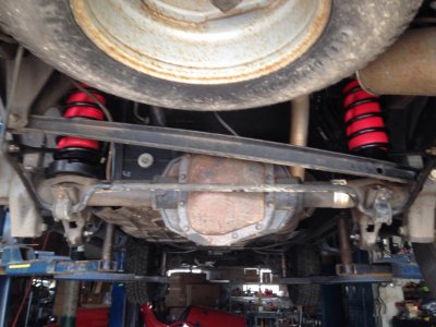

Finally installed the stuff I ordered
It took me about 2 hrs using a lift. The hardest part was reaching the bolt on top of driver side shock. I took some pics.

I have the same air bags. I keep 10 psi in mine all the time. It seems to ride better. I put 40 bags of mulch in the back and the guy at Home Depot was shocked it didn't even look loaded.

Yeah they are not too bad, mine seem to be a bit short (even fully inflated) and don't fill the entire spring though. Could this be because I went with a variable rate spring instead of a constant rate spring? I never even checked to see if they were the same height. They are also a little kinked inside , which I thought would go away once I inflated them, but it didn't. Oh well.

They aren't supposed to inflate the length of the spring. They push outward against the coils. Mine were wrinkled when I installed mine. They worked themselves out as you drive and are now all straight. Keep about 10 psi in them. I also sprayed mine down with silicone spray to help them move around.
