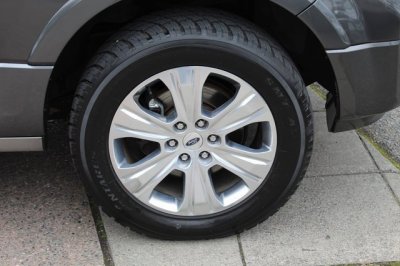

Yes it's true that CCD can be hard to find. It was optional and rather rare in 2015 and 2016. It became standard for 2017 but only on Platinum trucks. Even then, many lease and fleet 2017 Platinum vehicles don't have it. They ordered their trucks instead with load-leveling rear suspension in order to save money (the CCD and 22-inch wheels are a $3000 option). You can tell if a 2017 Platinum doesn't have CCD because it comes with 2015 20-inch wheels instead of 22-inch wheels.
Here is what Limited, King Ranch and Platinum 22-inch wheels look like:

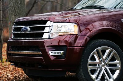

Pacific Northwest
This is a 2017 Platinum without CCD (it comes with 2015 20-inch wheels). This vehicle is almost certain to have load-leveling suspension:
