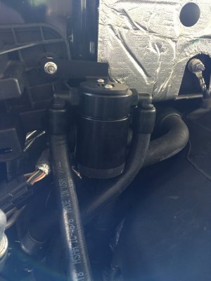

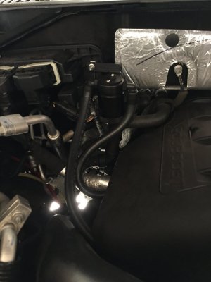

Hey guys,
I'm looking to install a JLT catch can on my 17 Expedition. I called JLT and they do not make a direct fit for the Expy. What kit are you guys installing?
chuck s
Dec 20, 2006
1,833
674
Took me 20 minutes to install this on my '17 Expedition and 10 minutes of that was getting the engine modesty cover back on. :) I think I need to reroute one hose but ain't pulling that cover again unless I have to.
Not yet checked the operation but I may have only been 1000 miles or so.
-- Chuck

Do the new hoses make reinstall difficult?

Thanks Black and Chuck. I spoke to a guy named John at JLT. He said they had nothing to fit an Expy. I'll order mine up.

Just placed my order. Chuck, if you wouldn't mind, a picture or two of your set up would be great.

Thank you Chuck. I'll post once I get mine installed. The unit is on backorder now but hopefully ship soon.
