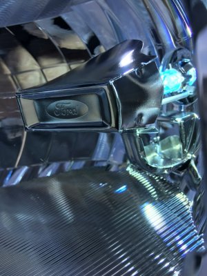

The bro got me these drop in LEDs for Christmas and while no retrofit or factory HID or LED System them are certainly better than the halogens they replaced and match the factory fogs perfectly.
I do not have LED high beams.
H11/H8/H9 LED Headlight Bulbs Conversion Kit, DOT Approved, SEALIGHT S1 Series 12x CSP Chips Low Beam/Fog Light Bulb- 6000LM 6000K Xenon White https://www.amazon.com/dp/B079KB7QX3/ref=cm_sw_r_cp_api_i_PfzxCbRH9EW3S
The direct beam patern is slightly deeper than the halogen. But the halo pattern is nearly identical just white insetead of orangish. You can see some of my green tape markings for alignment.
Pretty happy with a gift drop in option that do fit behind the factory dust covers so no modifications needed.
Perfect, nope.
Blinding to others, nope.
Better than factory halogen, yup!!
