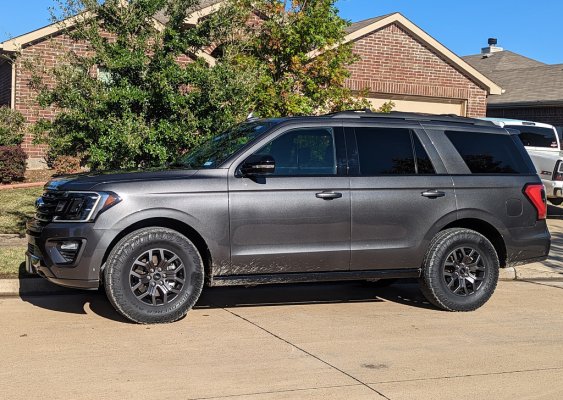

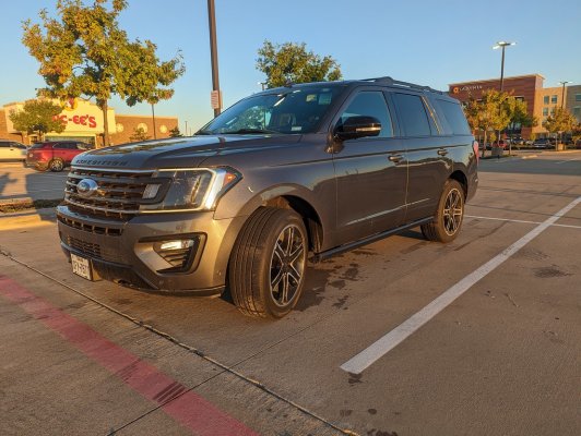

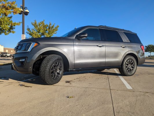

No lift yet...
275/70R18 2022 F150 Tremor take-offs from Marketplace... wheels and tires... on "Stone Gray?" 2019 XLT Max 4x4
275/70R18 tires are 33.2″ x 10.8" and I have NO RUBBING AT ALL. I am happy about that!
Trimmed rear axle shaft instead of spacers, I have the means to do this easily when needed... and I hate spacers.
F-150 Wheels need the trim, or a spacer in the rear to fit. (Found out after I purchased the wheels)
Currently Considering a very small amount of lift (not enough to tuck the rear wheels under and need spacers...)
Also would like it to still fit under the parking area.

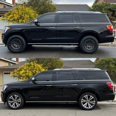

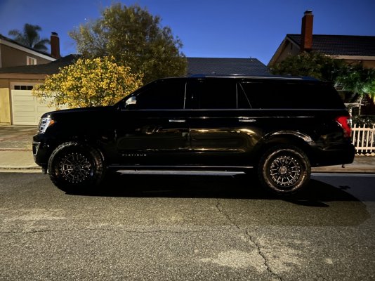

First post and long time lurker. 2018 Plati owned for about a year now. Learned a ton from these forums, thank you! Wastegate rattle fixed (Spring mod) thanks to you folks.
Just installed the RL 3/2 this past weekend with Continental Terrain Contact AT. 285/20/60. Slight rub on the running board at mid turn. Ride is excellent with these tires. Very quiet and much smoother than the 22”.
The Expedition handles the beaches so much better with the thicker sidewall.
