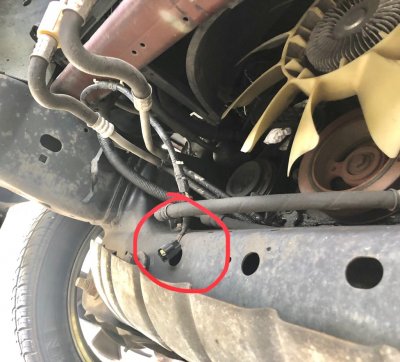

My airbag warning light has be on for a while now, so I decided to look underneath the front end of the vehicle and noticed there is a connector not connected to anything, photo attached with connector in red. Could this possibly be for the front impact sensor for airbags? If so, where would that sensor be located? Cannot seem to find it. If it's somehow missing, any idea what the part number is?

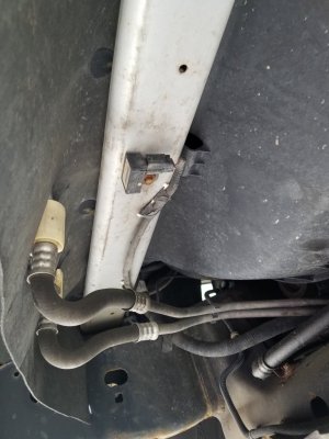

Is someone able to share a picture of what this connector plugs into on your car?

UPDATE - FIXED!
New sensor (part #14B004) was delivered today. Plug and play - airbag warning light is off!
