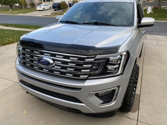

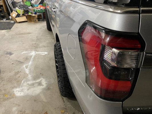

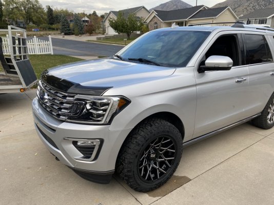

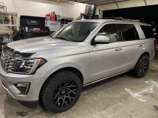

674F0A67-BD76-4724-B206-2F60563F0557.jpeg16110F60-C37F-4589-A9F6-41313A1950FE.jpegC4FA049B-7179-467B-9E6F-3C164898ADFE.jpegIn case anyone was wondering, negative offset wheels do fit on these vehicles. I recently installed some 20”x9” wheels with a -24 offset with stock size (275/55/20) mud tires on my 2018 Expedition and they do not rub at all. I tried to find out if they would fit before I purchased them and everything I read said no. So I figured I would put this out on here. Thanks

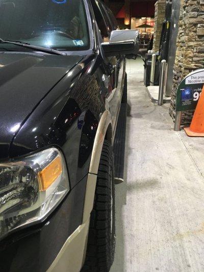

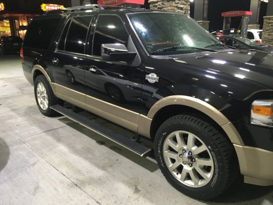

It looks like the fronts stick way out, but the rears don't.... Maybe its just that one pic...
14,561
888
Hampton, VA
its not due to his setup...mine looks the same way and i have 26s with + offset...its the design of the truck
14,561
888
Hampton, VA
and he only has the wheels on the front...he didnt change the rears yet but its still the same as i see the same on my truck
