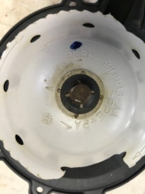

I removed the rear blower fan by pulling the panels back and removing the 4 8mm screws to find this. Replaced it with one from oriellys for $22.

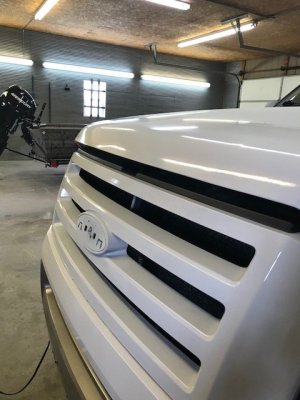

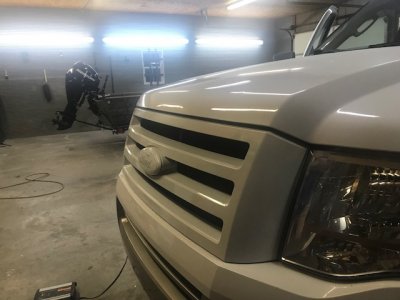

Grille Scuffed and painted Oxford white dupli color rattle can and cleared with Transtar Jammin clear-rattle can.

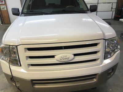

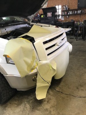

I sanded the bad spots down on the hood then primed them. Painted pics to follow.

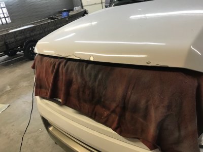

The rocker panels are crap on the 07-17’ trucks and they all rot out eventually. Fords design hold moisture and let’s salt in, I have new rockers but have yet to install. The hood and tailgate will bubble again it might stay smooth for a year or so the aluminum panel has iron contamination no amount of sanding and paint will stop the bubbling......it’s easier to just live with it or put a hood deflector on. Painted grille looks nice keep up the updates.

Here's the hood after I painted, blended and cleared it. All rattle can stuff. Ive still got to wetsand and buff it
