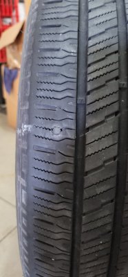

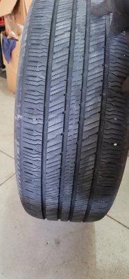

The service manager finally got ahold of me (probably due to my bad review on Google and a BBB complaint) and reluctantly agreed to replace the tire. I just got back from the dealer and requested to keep the old tire (photos attached). I figured since Discount Tire deemed it safe to repair, I'd keep it in case I ever have another issue with these tires.
The other 3 tires have about 26,500 miles on them and decent tread left. I was thinking going forward I might rotate the new tire back and forth in the rear and rotate the other 3 around that to try and wear the brand new one in more. Do you all think that's a good idea or should I rotate all four normally?

It looks like my puncture was in almost the same location as yours (probably just next to/inside of where yours was). I'm getting the sense that there's a big gray area as to what's repairable or not.
Anerbe
Oct 16, 2020
122
73
Mi
https://www.discounttire.com/learn/...ture must be 1,the internal steel belt begins.
Issue is that the belt widths vs. tread contact patch varies per individual tire, so without x-ray or physically cutting the tire, will you know where the belt package ends. You definitely don't want to miss to be within the belt package when repairing...a portion of the tire without adequate belt package will bubble like a sidewall blister and has risk of failure.
