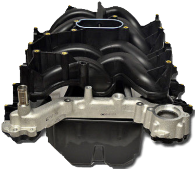

Yep. I just bought that Ford intake. Seems like a better piece than the Dorman that it replaced.

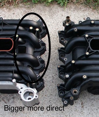

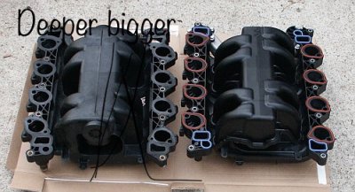

In my opinion having replaced one. Holding side by side the dorman has a bigger air box between the heads on the bottom, don’t know but might have given better air flow. On my 5.4

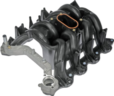

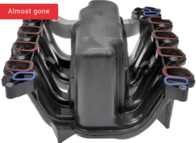

My Dorman looked anemic compared to those pictures. And the bottom picture, I think the Dorman is on the right.
The Dorman gaskets sucked for me. The manifold itself survived the 42k miles and 2.5 years- just not the gaskets. And the bolt holding the underside of the aluminum crossover was also loose and leaking (have to remove intake to get to).
