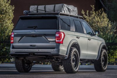

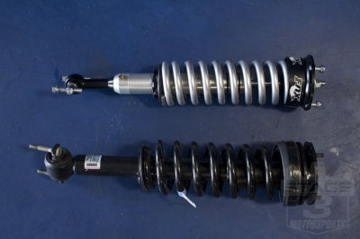

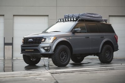

View attachment 24209 This one has Icon 2.5" shocks.
Yeah they are only available for the front so I’m betting there’s a spacer in the rear. Other thing is, they probably had to do some modification because the picture shown on their website is only for f150s and the bolt that holds the lower control arm to the strut is incorrect for newer mode years. 2014+ expeditions have two bolts that run vertically through the LCA, this only shows one running horizontally so I doubt they were able to bolt them right on. Spacers do no harm to the suspension and I dont see why you would waste $1500 on two coil overs when it does the same thing as a spacer. Unless you move every suspension component up like a $2500 lift kit would, it would t matter using these coil overs or saving $1100 and using a set of quality spacers
