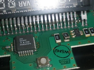

Apparently they haven't fixed it for the 2002 model either. Same issue, the 510 resistors break loose.
Remove overhead console by removing screw under the sunglass storage bin.
pull down in back to unclip 1 spring clip
pull down in front to unclip 2 spring clips
slide forward to release.
See Step 20
I was able to lift up the broken solder joint. After resoldering, it worked like a charm.

Hi all. I also have the 2000 Ford Expedition XLT Overhead compass and Temp Gauge problem. I got as far as removing console, finding both "510 modules" mentioned in rogerrabt's post were loose, but I can't get the solder to stick to one of the modules. Any suggestions? Can I buy just those 2 modules, or are they resistors?
Thanks,
Bill
