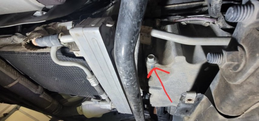

Most time consuming part is removing the felt protector where the oil drain bolt is located. I do my oil changes with the vehicle level and the trough Zak mentions where the filter is makes you think the oil will come forward. It doesn't do that, it still flows out the back of the trough so if you aren't prepared it'll come out where you aren't suspecting and make a mess. I found a guy on YouTube who took a 1 quart oil bottle and cut the one side off and put it under the filter in the trough before removing the filter. I tried it yesterday when I changed it and it worked really well and pretty much eliminated the entire mess I had the first time.

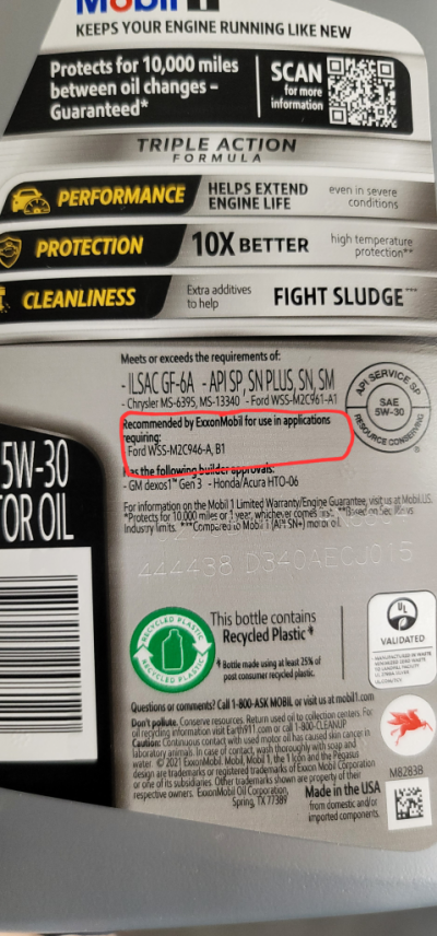

I use the Valvomax and it's working really well to avoid a mess. Also I believe the only Mobil 1 that meets the spec is the Extended Performance.

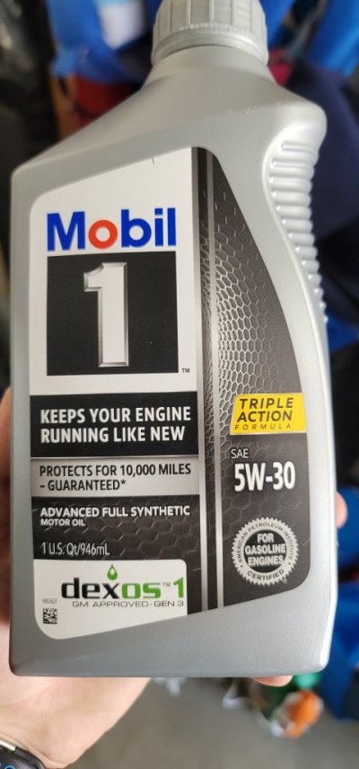

Anyone feel free to correct me if I'm mistaken, but it looks like this meets the B1 spec, no?

It does look like it yeah. And now I can't find the post on BITOG that detailed why EP met something or other that the Advanced did not. I put Advanced in my car as well, came across the BITOG post and figured I'd just use EP next time, not a big deal. Interestingly, if you put the Expy into the oil recommendation page at Mobil.com it will spit out the EP as the highest "performance level" for it, but both are recommended.
