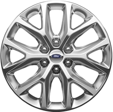

I have a 2006 Expedition with the factory 17" rims. I am needing new tires and am debating between new tires or new wheel/tire takeoffs online. In looking I have found that increasing the tires by < 1" in height should have no affect as far as rubbing but i want to make sure there arent any other concerns (tire pressure sensor, etc) by upgrading to newer factory rims. The bolt pattern hasnt changed, so i dont have concerns about the bigger wheels going on, just want to make sure i dont run into unforeseen issue. Any feedback/experiences would be appreciated.
I am looking to go from the current: 265/70R17 to the wheels/tires off of a newer Expedition: 275/55R20 (below). The actual height difference is only .3"
