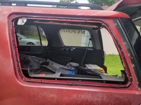

Ford discontinued the Rear Quarter Panel Glass with seal. Was hoping to find a non oem option or has anyone had any luck resealing the Glass?
Any help is appreciated..

Thanks @GaryH! I ended up resealing both rear quarter panel glass using 2 rolls of 10mm Butyl Sealant Tape. Removed them, cleaned the surface and seal attached to the glass. Placed the Butyl tape on the existing seal around the outside of the bolts. Put the glass back in and tightened the nuts. Worked like a top for $28.00 and approximately 1.5 hours to do both sides
