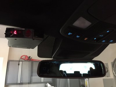

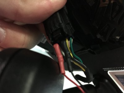

So I got out and messed around again and finally found the wires I was looking for. For those of you searching in the future: You need to tap the white (+) and black (-) wires on the mirror side of the mirror plug, and that will get you the power you need.
