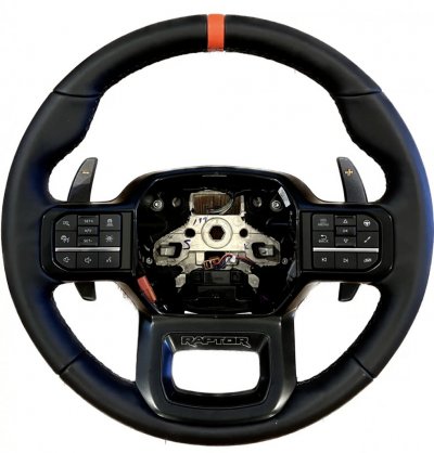

Has anyone put a Raptor steering wheel on a 2022,2023 Expedition?

For clarity, the 18-21 is not the same as the 22+. That being said, the 21+ Raptor wheel should be plug and play in the 22+ Expedition. You will use your buttons in your current wheel.

Good catch, my mind didn’t register the model year. Process should be the same as the 18-21 models.

Boosted grey goose designs makes a plug and play harness for the paddle shifters for the F150 not sure if there is a difference on the expeditions

Still looking for a Raptor steering wheel. Looking at getting it custom wrapped, so not looking to pay $1,100+ for a new one.

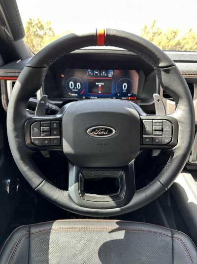

I swapped mine over a few months ago, you’ll have to use your stock steering wheel button clusters and wire in the paddle shifters.
Where did you get your raptor steering wheel?

What do you mean by "wire in"?
I’ll rephrase that, most of the Expys don’t come with the paddles shifter wiring in place. My 2021 had it but my 2023 didn’t. If the paddles don’t work after install the wheel you’ll have to run 3 wires from the main plug for the steering wheel down to the manual shift buttons on your console. Very simple harness to make. Google “ford f150 paddles shifter wiring” and there’s a few write ups.
