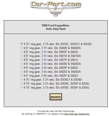

when i check out Car-Part.com--Used Auto Parts Market
these options come up
9.75" ring gear, 3.73 ratio, IDs S935C, S935C1 & S935D
(EDIT - looks like these are 97)
9.75" ring gear, 3.73 ratio, IDs S935E, S935F & S935J
(98-9)
from info i've run across, all 3.73 are limited slip, one diff i'm aware of is trailing arm bolts (& mounting holes) got bigger after the first year, but assuming that isn't a big deal as far as working eitherway
at some point early on, axle diameter increased, then wheel studs went to 14mm
i suppose these variations come into the picture with lettering like S935C-C1-D-E-F-J
main question is will any of these 9.75 - 3.73 variants pretty much bolt in for 98?
don't think any were drum brake, dunno if all 9.75 were disc setup? anything else to look out for?
