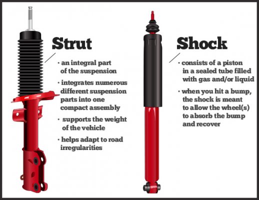

Are the rears on the XLT shocks or struts. The front was covered by the ESP but if the rear is shocks those may not be.

My dealer told me the rears are shocks and not covered by the ESP. I confirmed they're called shocks in the Ford parts catalog. They're coil-overs just like the fronts, but apparently only the fronts are struts. After 7 leaking shocks/struts I gave up and replaced them all with Bilsteins.

Under the "front and rear suspension" section there's no mention of struts. But in the copy I saved when I got my ESP a couple of years ago, it says "MacPherson Style Struts" in that section.
Aren't the rears designed the same as the front?
They look very similar and are both coil-overs.
