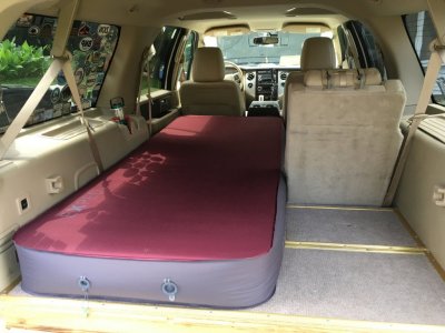

Love it. I turned mine into a camper but didnt go THAT far (removing rear panels). Can't keep my 2014EL cool in Nebraska in August without rear cooling but it is still more comfortable than the Lewis & Clark Expedition had it. Ha! EXPED Megamat makes a great bed.
Confused about your question about capping it off ... heat and cooling "fluids" run back there.
I kinda wondered how that worked and maybe instead of capping you have to make it circular if you know what I mean. Be sure to follow up with progress on your legendary project please.
Make sure you plug the bolt holes where seats removed. I used some of them to bolt the structure I put back there down (even that is insufficient in a major crash)
