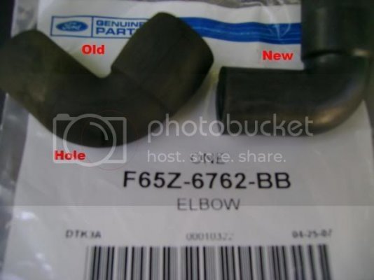

    Sounds like a vacuum leak to me. Make sure to check the elbow on the vacuum hose going into the intake at the very back of the engine near the firewall under the IAC. Betcha got a hole in it. You can stick your finger right in there, and feel a suck.
    Check this link for a better view. http://www.azda.com/ford/

    Was it codes P0171 and P0174 . Cuz that's the code everyone I've ever talked with had before they replaced their hose, or elbow.
    The easiest way to check for a Vacuum leak is just to climb up onto your fan shroud, reach under all those hoses to the almost the back of your valve cover on the passenger side, and follow it along all the way to the firewall where it goes into the intake. ( With the engine running, so be careful) and you'll know if you have a vacuum leak. Not only can you hear it, you can feel it. It is quite a strong pull on your finger. It might even be collapsed, or cracked.
    Just have a feel before you go replacing too many O2 sensors, or IAC's or MAF's or whatever the mechanic tells you you need. It's such a common problem there is a 7 year thread running on another Ford Truck site I am a member on.
    I'm not saying this is for sure your problem, but just check it first before you go spending $$$. And make sure you have a new part before you take the old one off, cuz it will crumble in your fingers when you take it off!!!
