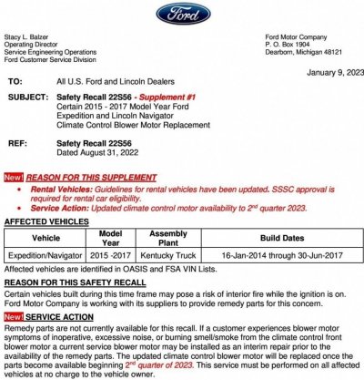

Availability of updated climate control blower motor has been revised to 2nd Quarter 2023, provision of rental vehicles for owners with unique circumstances is now possible when pre-approved by Ford...

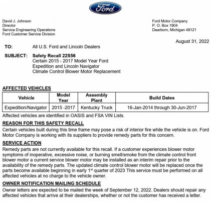

My 2015 Ford Expedition Limited 4x4, purchased new, has been under this safety recall since August 2022.
It has been parked at my Ford dealer now for 66 days, waiting on a steering gear that is under national backorder for Ford.
More than seven months have passed since Ford issued this safety recall and sent me a letter about it. I’ve received no further communication from Ford.
Yesterday I went to my servicing Ford dealer and spoke with a service advisor. She looked up the recall for my vehicle and confirmed the additional 3-month extension for the lack of repair parts.
She opened a repair order, to ensure that the repair parts are ordered for my vehicle (although on back-order). She said the dealership will call me when the parts arrive.
Ironically, there was a parts employee talking with the service advisor when I spoke with her. He laughed and said it will be a long time before the parts arrive.

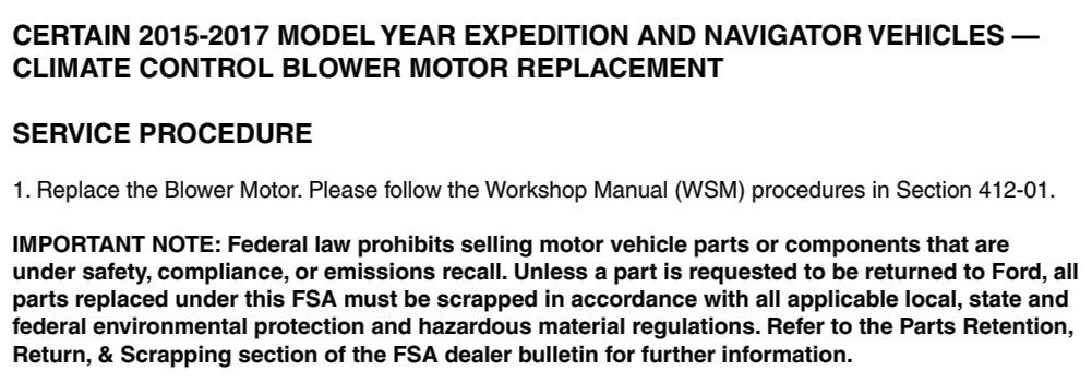

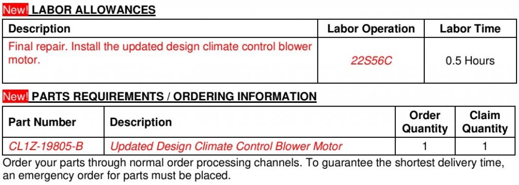

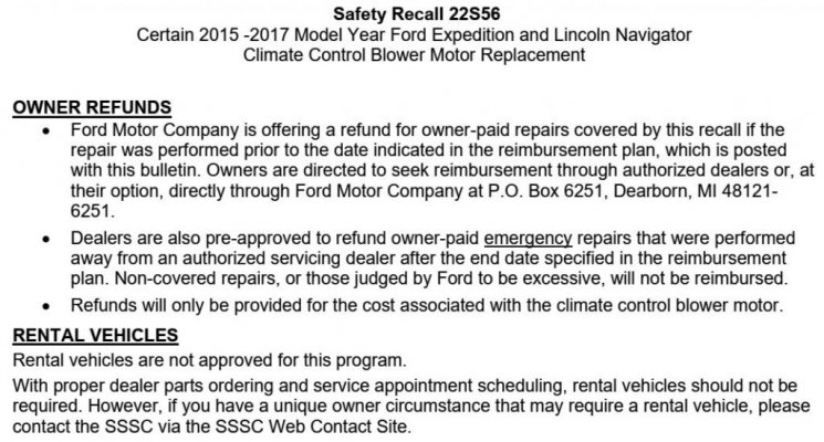

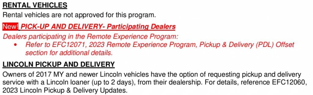

***Replacement Blower Motors are now available***
***Replacement Blowers Motors are also available for the smaller population of affected vehicles in Canada, however, owners in Canada are not offered Mobile Service or Pickup & Delivery***

The Supplement 2 Letter's advice to dealers, to identify their order of the Updated Motor as an emergency to ensure prompt delivery, indicates to me the Updated Motors have not already flowed into dealership Parts Departments.
I expect the Service Department technician noted your vehicle's 22S56 Recall status in OASIS and proactively installed an in-stock Current Service Motor to ensure your vehicle presented you no problem while waiting for an Updated Motor to become available.
The Service technician would have recorded the installed motor's part number in the submitted Warranty Claim, so if you contact your dealer, they can very quickly call up that record in OASIS' Warranty History to verify which blower motor was installed.
Contacting your dealer also provides you the opportunity to schedule the Updated Motor replacement, since affected owners do not need to have received the "Parts Are Now Available" Owner Letter in order to have their vehicle repaired under Safety Recall 22S56...
