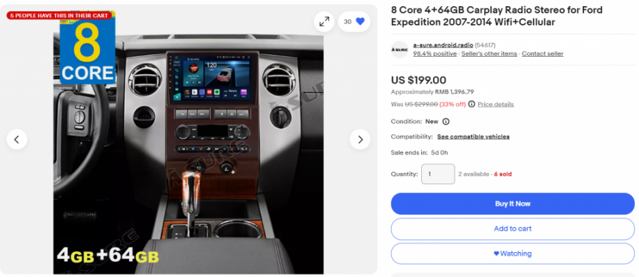

I am curious. I have a 2013 XLT with a basic AM/FM/CD/Aux/Sirius head unit. It also has bluetooth integration for the phone. But the display is so limited as to make the phone operation user vicious. Can I step up to a higher level head unit from the used market and perhaps even get a rear camera? What would I look for and how do I make the vehicle accept the upgrade?
Yes, you can upgrade to the OEM NAV unit but you'll need the additional amplifier, wiring harness, and backup-camera harness to bring the camera feed from the mirror to the head unit. This runs anywhere from $800-$1400 for 10+ year old technology and no upgrade options.
For about half that, you can upgrade to a modern headhunt with CarPlay/Android Auto, Bluetooth, and multiple cameras and use a Maestro box to interface with the CAN-BUS system and steering wheel controls. Usually $500-$1000 total.
