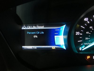

I've heard members on here say they get almost 10k between oil changes. I purchased my 17 and after 3-4k miles it was time to change oil. Well we've only put around 4-5 hundred miles on truck since oil changed. And it's down to 68% already???
Truck runs fine and gets decent mileage. Does it's far share of curb idle thou, with the remote start.

68% on the dash display. The oil is still full and clean. I dont have the catch can yet, but ordered one yesterday. I changed the oil in my Suburban last fall, and it still shows 65% on the dash display, I'm not sure how many miles without checking my log. But 32% life gone from 5 hundred miles seams far from normal to me. At this rate it will need changed around 1500 miles, per the dash display.

From what I've heard ... No sensor that measures oil lubricosity. Its an algorithm (translation for Moose = Formula). Probably takes into account the number of milliseconds the engine has run as well as temperature, speed, whatever metric the computers can record.
This is one of those situations where the owner says ... Looks clean, has X miles, has X months ... All good! F that annoying notice that keeps popping up, I'll reset it
I'd copy and paste the link if I knew how. But you can Google "understanding ford IOLM" to learn more if desired.

On some it’s a fixed variable of time and mileage, many of the newer trucks use more variables in determining the oil life like temp and trip duration. My 2007 is a bit more basic and the owners manual says the following regarding the oil life monitor:
“Oil life
An oil change is required whenever indicated by the message center and
according to the recommended maintenance schedule. USE ONLY
RECOMMENDED ENGINE OILS.
To reset the oil monitoring system to 100% after each oil change
[approximately 5,000 miles (8,000 km) or 180 days] perform the following...”
