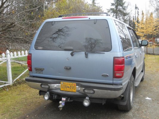

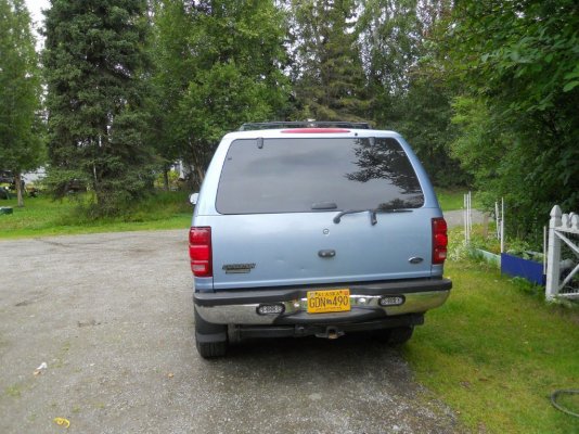

Hey you found me:happy107: I was wonder if you can get rear view of expedition I want see how wide tires will be look like.
I am concern about mileage from light tires to heavy tires. Won't it affect or just little?

i dont think you will see much if any difference, i could very well be wrong but who knows?
heres a bad pic of my summer tires. keep in mind i run 8" wide wheels in the summer also which makes it just a tad wider then stock 7" wheels
