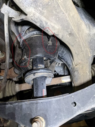

The Sumo Springs did nothing for me (2016 Expedition EL Limited, HD Trailer Tow Package). And they fell apart.
I tow ~ 5000Lb (aluminum flatbed with 3200lb Corvette), tongue weight < 700lb no WD + ~250lbs of tires+tools in the back. The Sumo Springs did nothing. They did not reduce the rear sag. And they made no difference in the ride quality. Worse yet, after < 3k miles of towing, I see that the Sumo Springs have basically exploded (see photo).
I cannot recommend Sumo Springs.
Now, if anyone has a recommendation for rear springs that are stiffer than OEM ... I would love to try them with new Bilstein 5100's.
Did you ever figure out why the Sumo springs came apart? Any conversation with seller or mfg?
