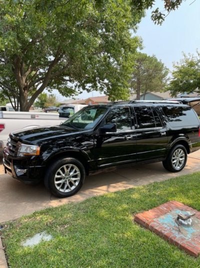

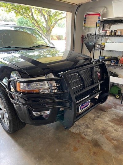

We just ran into this problem on our 2016 Limited EL w/ 75k..... that we purchased September 11th of this year! Yeah a month ago. Our warranty covered it, but a real pain to have happen after driving for a week or two. Of course we had to wait a week or two to get it into the dealer to fix, but its fixed.
After learning that it was the throttle body, I looked up pricing for a replacement. Not too bad, I think the OEM was around $200 and aftermarkets less than that.
I am curious now, if after replacement it is a permanent fix? Or should I expect it to come back up down the road.
If the chance of it happening again, I think it might be worth buying a backup to stash in the truck for road side replacement if needed.
Pictures, because posts don't count without them....right?
