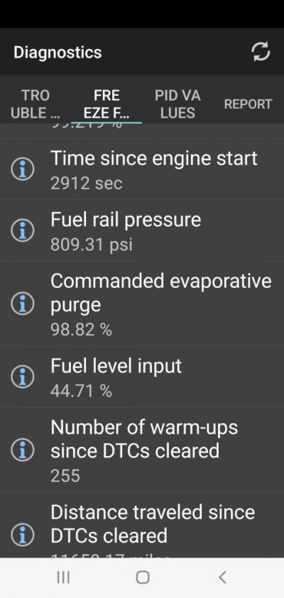

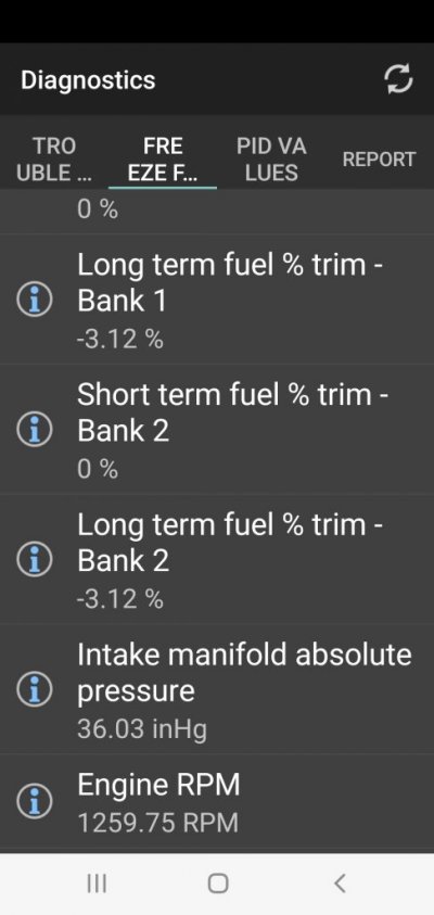

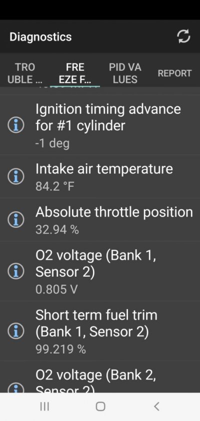

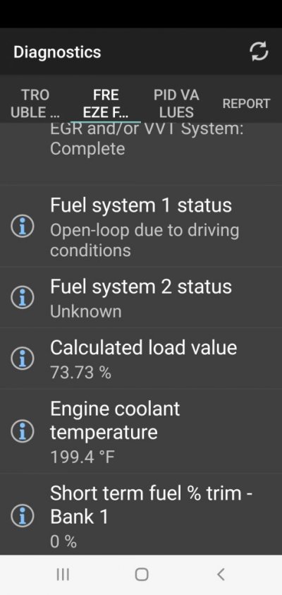

Assistance Requested On The Following Problem Arising Today.
2017 Expedition Limited. 46,000 miles with no current issues or problems; until today!
Although we have had battery management and TBC grounding issues in the past, which the problems and resolutions were well documented by past posts (hope they helped some), this issue is brand new and very much out of left field, so some assistance is much appreciated from the group.
The vehicle has been running well and has been used on a daily basis since early May (stored for the winter).
Today in the Northeast, is a beautiful 75 degree sunny day. We took a ride to pick up some things, 45 min highway up half hour engine off and 45 minute back.
We then headed out to lunch on local roads. 5 minutes into the trip, the engine went COMPLETELY LIMP, no throttle interaction at all. Moved to the side of the road, still no throttle and message “SEE OWNERS MANUAL” WTF!
No errors other than wrench symbol. Shut engine down, waited 2 minutes. Restarted with no issues. Drove the rest of the way to restaurant without issue.
About 1 hour at lunch, back in truck, started fine, I was attuned to pedal movement / throttle reaction and it seemed slightly delayed or rough. Then 3 minutes into drive, same situation, complete limp, no throttle reaction to pedal movement. Side of the road again. Idle rough. Shut off, wait 2 minutes, restart fine and made it home with less than smooth throttle reactions but no limp.
In the garage now. Looking for advice before I need to bring it to the dealer. It is under premium extended warranty, but not looking forward to a 2 week wait to look at it and 2 more weeks for repair.
Screenshot_20230803-164005.jpegScreenshot_20230803-164023.jpegScreenshot_20230803-164033.jpegScreenshot_20230803-164043.jpeg

Some good news, our local dealer, Park Ford of Mahopac, told me they were pretty backed up, but bring it in ASAP and if they had any open tech time they would look at it.
I had it there in an hour with the diagnostic report pretty much showing the failure / solution, but it did crap out 2X leaving me on the side of the road during the 10 mile trip there.
They called me 6 hours later telling me they were able to confirm our diagnosis and source the throttle body from another local dealer, got it installed and all is well.
So for all the bad news and outcomes we have all had to endure, one good outcome.
