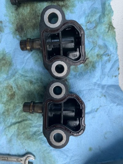

I’m about 2/3 through the job, and I’m glad I did it. Both tensioners were blown out.

The fruits of my labors.

Typical blown out tensioners..ugh.
