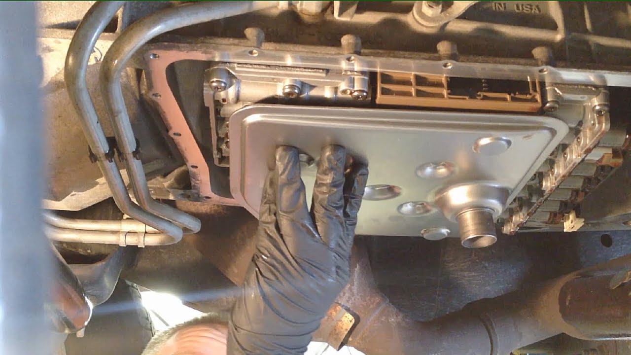

Changing the transmission fluid on these isn't too bad, but is definitely easier if you have access to a lift since there is no drain plug on the pan. I used a vacuum pump through the dipstick hole to lower the level before dropping the pan and it went fairly smoothly for me. The dipstick is located on the passenger side of the transmission just above the front side of where the transmission pan is located under a cover bolt (also next to the catalytic converter which makes this job unpleasant).
There are also some good YouTube videos on this like (https://youtu.be/LZGLpsRccAo) and it is the same as the F150 procedure so you may find more resources searching for that platform.

I just changed fluid and filter on my 2013, and while is more difficult to fill and check, it's still pretty straight forward. Just a bit of a pain to fill and check. There is a stubby trans fill tube with a threaded in cap. Remove cap, underneath the cap is a short plastic indicator to check fluid level. You have to pump fluid into the trans, that's the biggest difference from a normal full length tube and indicator. I spent some time getting the truck up in the air and level to make the job a bit easier.
