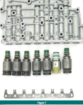

These transmissions are heavily solenoid based, likely the solenoid. @370k miles I’d drop the pan and replace the solenoid to see what happens. Nothing to lose if it fixes it it was an easy repair if not well you know what must be done.

Took it to my mechanic and he replaced the solenoid. Thankfully, that fixed the problem and the transmission is shifting normally again.

Not much to it if you need to change the fluid anyway. You can buy the whole bunch of solenoids in a pack, replace the fluid transfer sleeve which channels oil from the front pump to the valve body, and the 4 rubber sleeves in the ports that deliver oil to the box from the valve body and do it all at the same time. If that and new oil don't fix it it probably has serious issues. It all can easily be done without removing the trans. You should get a code directing you to a single solenoid if needed.
