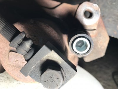

What type of Caliper Bolt is this?
intelisevil
Nov 19, 2016
19
Sandy, Oregon
I finally got around to installing the new rotors and pads on the front of my '03 Expy. I had searched and read posts and viewed videos so I was ready, I even bought a socket set with a 7mm allen socket because I knew I'd need it.
On the passenger side I removed the caliper first (7mm allen head bolts), then unbolted the bracket because that's what everyone said to do. Success, everything went back together just fine.
On to the driver's side. I thought I'd try something different, I removed the bracket and caliper as a unit planning to separate them afterwards. I'm glad I did . . . the caliper bolts are NOT 7mm. It looks like they might be 9mm? The socket set I bought has 8mm (too small) and 10mm (too big) but no 9mm! None of the sae's in the set felt correct either. Beyond this problem I made a positive discovery, you can replace your pads without removing the caliper bolts from the caliper bracket!!!!!

Are you the original owner of the Expy? If not, the previous owner might've replaced the caliper, and that caliper came with new bolts, which might be SAE 3/8" or 7/16" allen.

Here are the sizes --
8mm too small
11/32 is 8.73 mm
9mm
3/8 is 9.53mm
10mm too big.
Hope this helps some.

I have done mine twice now (once for brakes and once for bearings) it is a 9mm allen key. I just bought a cheap set from Harbor Freight that included the 9mm, seems very difficult to find separately.

NAPA sells it separately
I had to buy one
I ran into the same thing but I thought I had bought a 7mm but cant remember now
