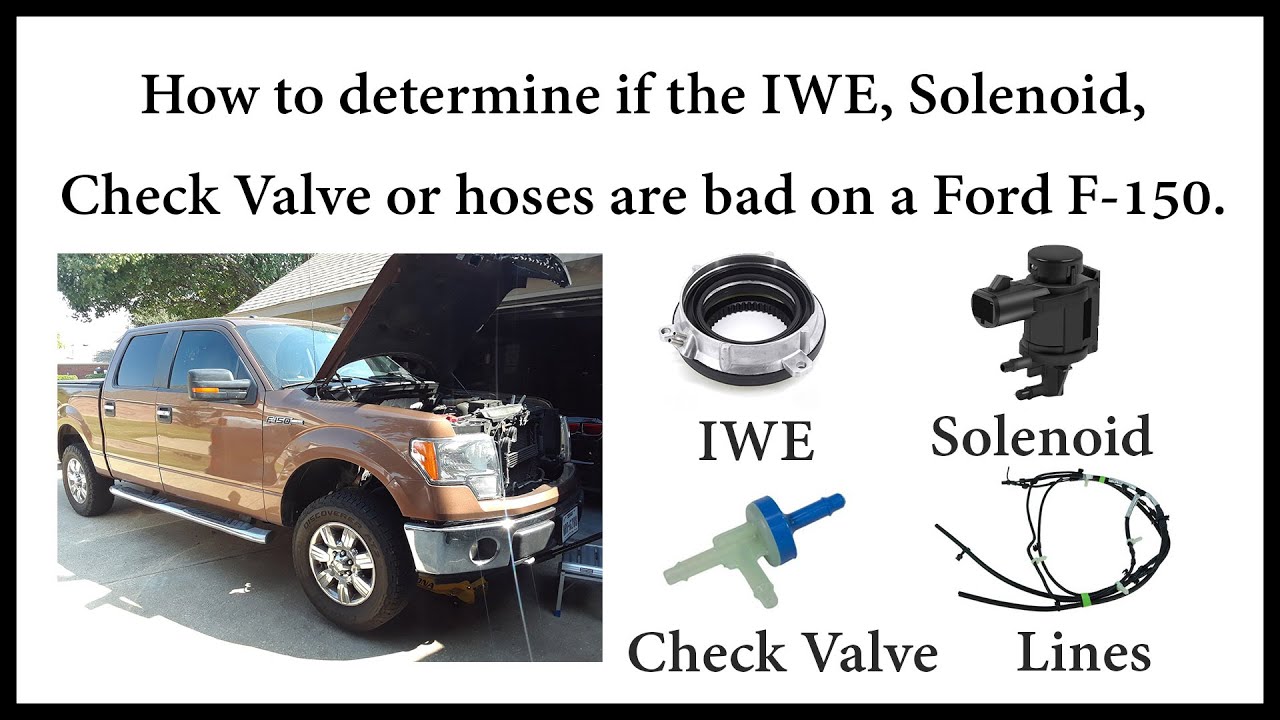

It could be something simple like the IWE solenoid and/or check valve. Mine used to make intermittent grinding noises especially when transitioning to uphill, but an easy $10 check valve fixed it. When it first happened I thought the timing chains were about to fly apart!
