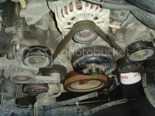

It seems I have a 6 rib system.
Here's what my engine used to look like.
