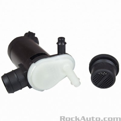

No. There's no solenoid involved. The pump spins one way for front washers, and the other way for rear washer. Look at the washer pump in the reservoir, that's where both hoses connect.
“We” know the pump work because I have fluid to the front. I can hear the pump run when I call for fluid to the back wiper but no liquid.

The pump and relay are working. I disconnected the rear line at the reservoir and attached a temporary hose. It pumps out fluid when the rear wiper is operated. Once again I tried to blow air through the line from both ends and it was unsuccessful. It’s blocked somewhere. I’ll get pics later but I’m 99% that the rear washer fluid line is running along that channel in the floor on the passenger side and not in the headliner. I can’t mentally process that the line somehow became pinched or blocked.
