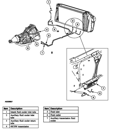

Any clue as to which line is the "hot" transmission line? Adding a couple tranny coolers and want to make sure I connect them up properly. Or which side is hot on the aux tranny cooler?

Here you go. The picture of the radiator is wrong, at least it is not what I have in either my 03 Navigator or my 04 Expedition. The cooler ports on the transmission are labeled properly. The lower steel line is the hot line.
