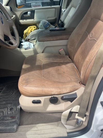

I am new to the forum and thanks for having me. I Just got this truck as an uninsured “guest” in Our country decided that I didn’t need my ‘14 FX4 anymore. Anyway. They have replaced the drivers seat with a king ranch seat. Bottom controls look identical to the passenger side. I have seen the videos that show a bad splice in the wiring harness behind the fuse box on the passenger side kick panel. These are for 2004-05s. The door panels are different and I can not find that splice in the harness of this 2003. I am going to guess that the harness is different. Does anyone have any info for me. I have ordered a 2003 shop manual but it hasn’t arrived and I am impatient. Any help would be appreciated.

The seat trim and controls look identical to my 2004 Eddie Bauer so maybe they only changed the seat itself and not the base.
